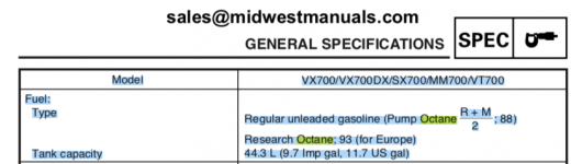

The Viper does NOT require premium. I have the 2002 Yamaha technical update book right in front of me. Bottom of page 2-52 - 'The SXV uses standard BR9ES spark plugs and runs with regular unleaded gasoline.'
Well I'll be dipped.. thought for sure they needed 91 octane as well!
Its odd, because they say 91 for an SRX that has less timing than a Viper.
Yamaha does recommend premium for the SRX models
today's gasoline is not the same as it was in 2002, I would definitely run premium!
