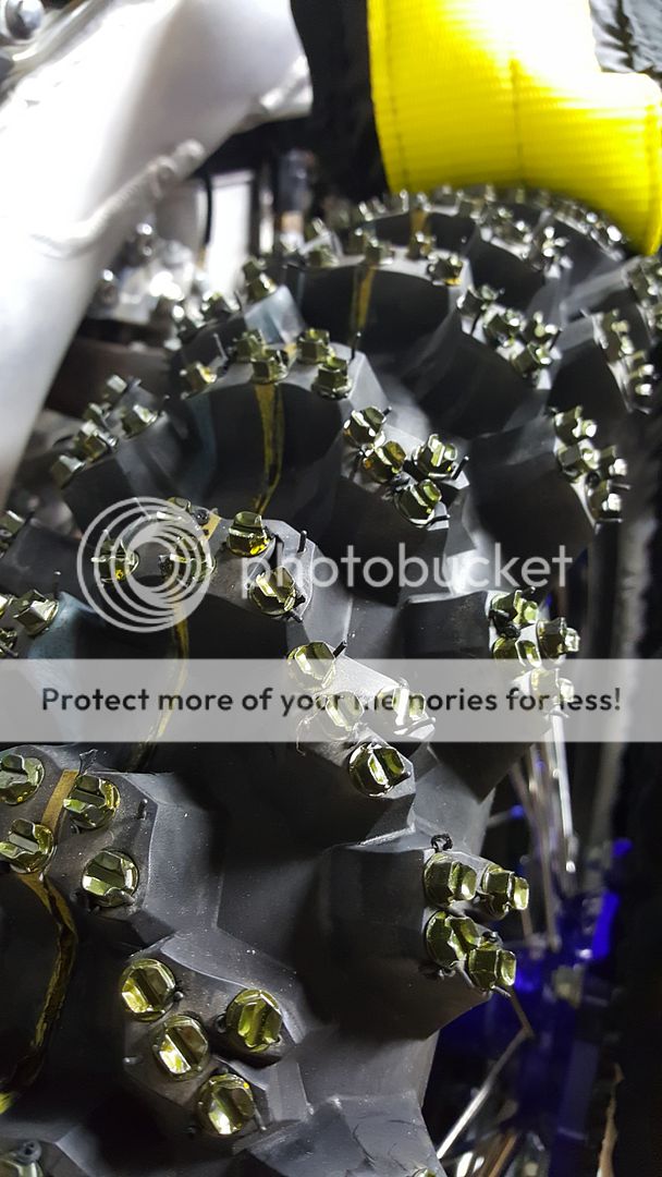

I will be up to see you soon Joe. The power valve tester isn't needed just yet and i know its hanging in your garage. I need to confirm that the valves are my problem as discussed above. Last winter you were out on the ice when i couldn't pull RPM on and off. i will be up real soon for a test and tune date on the lake. Also just about ready to run the new secret weapon.
