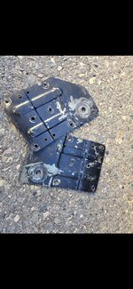

Sweet!!!Back at it.... now the SC5 is in the actual sled it was intended for.
Going a completely different direction then my original plans now that I see the skid placed in this second sled.
Looks like I ll be able to use factory short track brases for the rear mount of the new skid.
