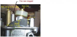

One of the Carbs was dirty, on the bottom of the float bowls, with the fuel drained out, there was small grain like deposits, almost looked coagulated, (Looked like little boogers). Cleaned them up, and the idler valve was very clogged sprayed some choke cleaner and used a little air, no more blockage.
