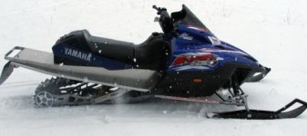

You can put the thick plates on the inside of the tunnel if you want. I have done it w/ no problems on two sleds. You just have to have your spacers cut 1/8" to maintain the proper tunnel width after it is all bolted together. You should still use the stainless steel plates they provide too......the soft aluminum can scuff and wear if the plates are not there (been there done that). If you are doing this you may want to scrap the plates they provide alltogether and have your own cut out of 1/8" aluminum.....that way you can run them further toward the front of the sled to help tie in the bulk head with the tunnel. This will help stiffen up the entire sled. Here is a photo of my sled w/ an MPI tunnel.......notice, the plates are on the inside
