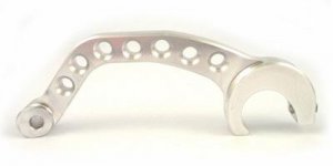

For a little more money you can order a pair of rox mounts from rich about $55 canadian funds shipped for you power mad handguards. They lokk very sharp and fit better than the powermad mounts. I got a pic from a fellow ty member , take a look. ;)!

Thats why the rox mounts fit alot better.

So can I still fit my stock SRX cover over my sled if I put handguards on? the handguards look way sharp; especially with the Rox mounts.
