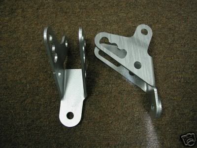

L to R & T to B...ground down & a few washers. They fit back nice & flush. When inserting shocks, the "new" mount angles the shock more to the rear causing it to miss the bottom mount. I can easily make it fit. Now that I look at the top fitment...will this cause any odd wear in the top shock bushing/collar? Seems to be done enough on here...any issues. Thanks, Fro.
I bought a set of SS ones for the purpose, and if I remember the one hole was slotted to allow you to get the correct angle fore/aft. Lots of versions of mounts around, I think the Sno-Tek ones are the nicest version made, they also have 3 angle adjustability in/out.
Marty those brackets will not work with the Viper "clevis" style shocks. Made for stock type KYB's or Ohlins. They are 36.99 I believe.
FRO......I also was in the same situation as you were.Just pulled the shock in to line it up,and there is some twisting of the bushing on top.Should still be good to go.
Marty they raise the front of the sled up, and when going to a wider front end, you alter the angle of the shocks sideways, with these mounts you have someadjsutability to bring the shock back to the more original vertical position. The more you lay the shock down on it's side so to speak, the softer acting it becomes because it is stroking less as the sled moves.
I got the brackets to fit flush, then istalled the shocks. I needed to take out some more material on the bracket. It was hitting at the top of the spring...not now. Fits better, no need to force it. I'll still watch the top shock bushing/collar for wear tho.
