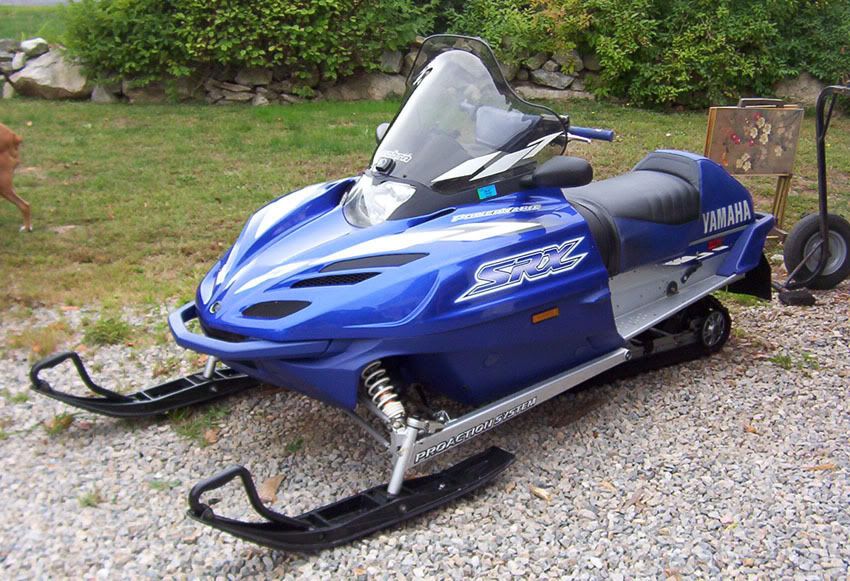

You can see here i put the RX1 skis, but also changed the trailing arms to make up the diff.

Hey what size windshield is that? That looks alot better than mine for coverage.
yamaholic22 said:
That looks like a sportech high flared windy
I think it was just that, A SPORTECH COBRA CLEAR 19.5 high.
This was a great investment and the hand protection better than my Venture OEM one
