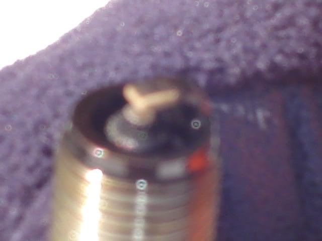

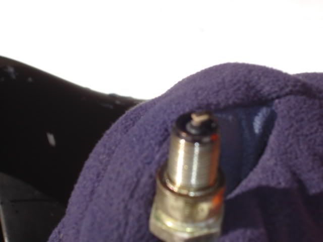

What do you mean by 300-500 feet? Daman I just want to say thank you for all your help. This is my first year riding with my son and you have helped me so much.
No problem,i know how frustrating it can be to not have things working out
and any info would be appreciated..
run the sled 3-500 feet in that range then pull plugs,you don't want to
do a long run and chance a burn..if jetting is ok do a longer run 6-1000
feet,etc..
