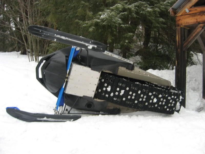

Okay guys, I was on vacation for a week at the cottage and I tried making some adjustments to make my Viper pull the skis a little bit.
I put my transfer rods to the redline, loosened out my straps, but no difference. I was not able to adjust centre shock spring preload however. I didn't have any tools in my kit to do that. Has anyone made these adjustments before?
My Viper on it's side... trying to make the center shock adjustment.
See where my limiter straps were originally. See next picture for where I adjusted both of them to.
I could not get the gold/brass colour nut and the aluminum adjustment nuts to turn. I was using a single ski-doo adjustment tool to try the adjustment.

akrievins
I was really hoping to adjust this while it was in thee skid. I guess I can't do that.
Looks like I'd also I have to buy the shock wrenches then correct?
You can adjust in the skid but, I'm sure it''s pretty hard? gl
viperino
it can be done while in the skid using a nice long flathead screwdriver and hammer
akrievins
ahh... good idea!
My spring was so loose that I could turn it by hand. It really needs to tightened up.
Canuck
I noticed that the full rate adjuster is in the center position, try it in the soft position and it should give you more transfer. It's a pretty quick adjustment if you don't get the desired results.

The limiters seem to be adjusted differently, does it pull to one side on launch?
akrievins
I adjusted the other strap after taking the picture. Both are now equal.
I guess I will try the quick FRA adjustment! Pretty simple to do.
