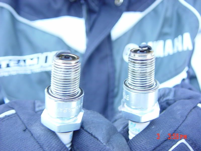

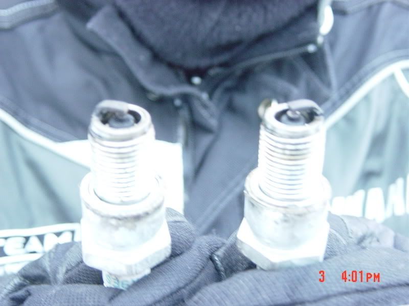

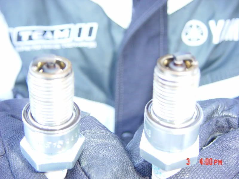

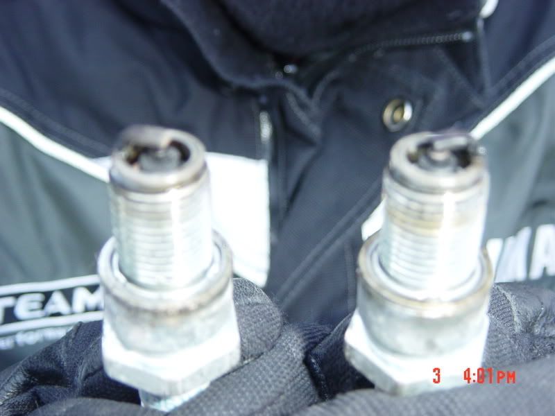

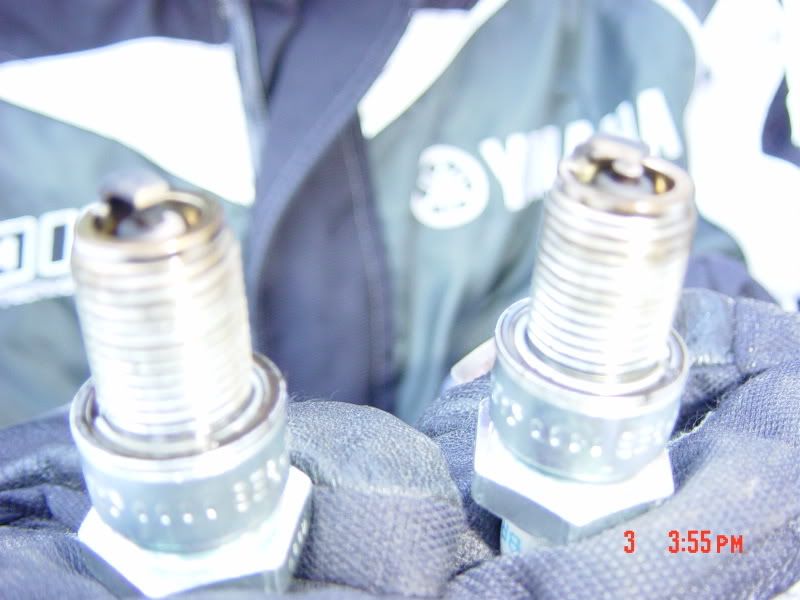

Just came back from 34 miles with switched carbs. My sled with my sons carbs got 8.10 mpg and my son got 6.80mpg. Now i know it is in the carbs even though I still had my mid range problem at 5 to 6 rpms. What inside the carbs would cause him to use 1 gallon more than me in 34 miles. My sons carbs on my sled are all stock with needle at 2 and pilot screw at 3/4 turn and the float tab bent down just a little. My carbs on his sled same thing but needle set at 1.5. I took spark plug pictures and will post them. Had trouble with camera again.
WOT my sled
WOT my sled
5krpm my sled
5k rpm my sled
5k rpm sons sled
WOT my sled
WOT my sled
5krpm my sled
5k rpm my sled
5k rpm sons sled
pup what are you seeing for engament RPM's then WOT??
they look rich yet.....
pup55
The clutch engament is around 3500 and at wide open about 7000.
ok,your not at your peak yet(7800)but thats not your problem here just saying,yea your rich yet....
