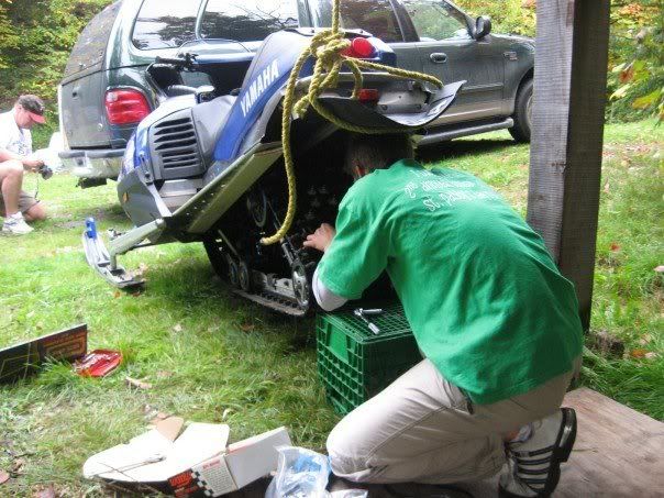

I am installing 5/16 studs in my 03 viper with a stock track. Is it better to buy a track cutter tool or can I use a 5/16 drill bit? Also what is the best way to drill the track, should I let the rear of the track down by removing the rear bolts or is there a better way?

i'd just buy a track drill, they sell for like 13 bucks at startinglineproducts.com, how many studs are you installing and are you using a pattern? best way to do it imo is to take the track out. thats a job and half though, if your tight on time just pull the skid out.

Just finished mine on the same sled!! The track drill is a must have. Makes it so much easier. I used an electric drill with a 1/2" socket and a 3/16" allen wrench and did it with the back end propped up with me on the ground. About three hours. Make sure to loosen the track and remove the belt to make it spin easy!!

I am going to buy the bit. I will not have the time to pull the track, I will try and prop it up and drill it. I made a template myself and will use that. I am using 96 up the middle.I live in Ma and travel to work in Pa and don't have the time so I am looking for the best and fastest way to do it. I have 2 03 vipers and I am sending one to the shop next week to check it out. It has 4000 miles on it and I just bought it so I want to make sure it is set up right. The one I am working on has 1800 miles and is all stock so it should be in pretty good shape. Thanks for your input.
