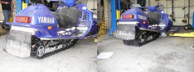

Please don't mind the dust (it was uncovered in the garage all summer!) or the tear in the seat (it's old and used!).
Before and after pics of an M-10 suspension installation.
Can't wait to test it out!

The swap out wasn't too bad because we did it on a two-point car lift. Would not have wanted to do it laying on the floor!
No, it's more than just bolting it in. There is some grinding that needs to be done. Need to grind off a bunch of rivets and parts of the old tunnel brackets. Then install a new tunnel plate with new rivets. New holes for connecting the suspension to the sled. Overall, not too bad actually.
DeviantSRX
Yeah I bet the lift was a definate plus. That dosent sound too bad as long as the all the rivets dont start to spin. How long would you say it took to get it finished?
igolf
It took maybe 4 hours. No problem with the rivets. Just grind off the back side and punch them out.

I was curious about that as well. I noticed the height difference from the pics and was wondering if you had plans for the front. You can't just leave it that way can you?

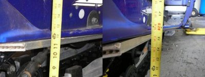

Here you go NY AttakGT. Both sides are identical. I would say just under an inch to the center of the bolt. Could you do me a favor and take a picture of what you changed on the front shock bracket?
vmaxx4, if your sled was off the ground how much do you think your track would hang below your slides? I set mine up tonight to the point where it was hanging around 1 1/4 inches. I noticed tonight that my slides will not fit out through the holes in my track so I definitely don't want to have to change my slides anytime soon!! With my old suspension is was best to run the track as loose as possible also. 1 1/4 inches looked like a good starting point to me.

igolf said:vmaxx4, if your sled was off the ground how much do you think your track would hang below your slides? I set mine up tonight to the point where it was hanging around 1 1/4 inches. I noticed tonight that my slides will not fit out through the holes in my track so I definitely don't want to have to change my slides anytime soon!! With my old suspension is was best to run the track as loose as possible also. 1 1/4 inches looked like a good starting point to me.
I think about 1 " would be right. I've never actually measured, have just gotten used to looking at it over the past few years. My rear shaft bolt measures 1-1/4" to center from the running board. I always remove the skid to change sliders. This is the easiest skid I have ever removed/installed. The trick is to remove the upper bolts for the shocks to collapse the arms. Then once the skid is bolted into the tunnel, lift up on the rails with a floor jack and line the shock mounts up and insert the bolts, front first then back. I received a video from fast when I initially purchased the installation kit for the M-10, I think it said to unbolt the rear shock only but I do both.
