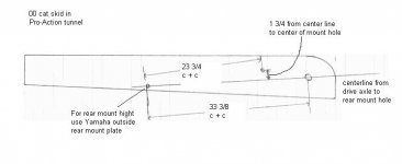

You guys are awesome! So where do I get Sno-xr's dimensions? Also does the track matter? This sled only has 600 original miles so the track is fine or do I need to swap?
Here are the dimension. they are sno-xr's dimension so give him the credit. you dont need to change the track unless you have an extended length cross country suspension, like a 136 or 144.

Thanks a million! You guys rock! I will post pics soon. My guy should have the install down within the week. Did any of you guys do anything to your front suspensions?
Just an update, I am getting an 02 Cat Smart Ride? But using Fox shocks. Same skid as the CC but it is black anodized! It should look trick! I'll post picks as soon as its done.
