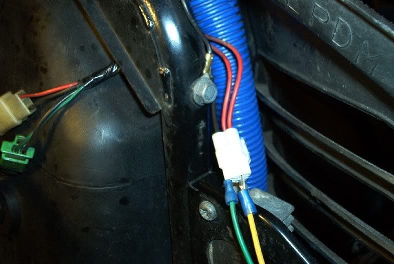

Bingo thats the one you use,remove the plug, there's two hots and one ground,use a open end wire term. to fasten to the two reds.TITANSS said:white and is trianglular shaped with a protective plug cap.

Only have 1 red wire, and 1 black. Sled is a 2000 SRX 700. How about as Viper-rules said, just turn servo with pliers, mark it and go. Just wonder about over-turning it past where it would stop when powered on. Did just turn it till snug, undid servo screws and tossed in two 2.8 mm nails, also felt up into cyl, tops of valves are even with cyl wall. Sound good to anybody? thanks to all, al

in the trianglular shaped plug you only got 2 one of each???? hmmm,thats not right

one of each- that's it
Felt up into wire harness-loom no indication of wire that is cut or pulled. Has solid plug of foam where 3rd wire would be. Will not open with harness hooked up. Tried first with key off then on, nothing.

Ya know i just went and dug my SRX manual out and that may be true on '00 model's(or some) there may only be a two wire servo plug,my '01 has the 3 wire.
so you may have a problem with your CDI or servo,have any lights on flashing before?, anyway idling it down should work....

My 2000 only has two wires, 1 red 1 black. The red one is the power and the black is ground. Still has 3 wire triangle connector but one hole has nothing in it.
