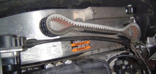

these are some of the pics of the brackets I made for the Floats. The sled is VERY dirty ! I just got it out and started from it's long summers nap ! It rode so much better with all I did to it last year, widening, Floats, M-10. Sucks the bumps up awesome! Rides straighter with the wide stance (both skis aren't in someone elses tracks at the same time) in short, less darting. Thought I'd share these pics for thos who wondered if, and especially for those who said it couldn't be done !! It still has the Viper bulkhead in it. I know one way of doing the aftermarket shocks is to use an sx bulkhead But mine's all Viper !

Looks good but what`s with the box bolted to your steering post and did the shock set up change the ridding hight up front much ,my nephew ownes a 05 f7 snow pro and likes his fox float shocks ,but dont forget your pump home while your ridding my nephew did just that and let the air out of the shocks to do a little drag racing and when he was done he relized he left his pump home so it was pretty rough rude until the next camp were buddy had a compresser lol.
the box is the way I widened the Vip 4" because I didn't have access to the material to make longer radius rods at the time. It did change the ride height but it's still level because I installed a M-10 in the rear so everything went up. And I have a box I fabbed that mounts on my belt guard that cradles the pump fro the Floats.
