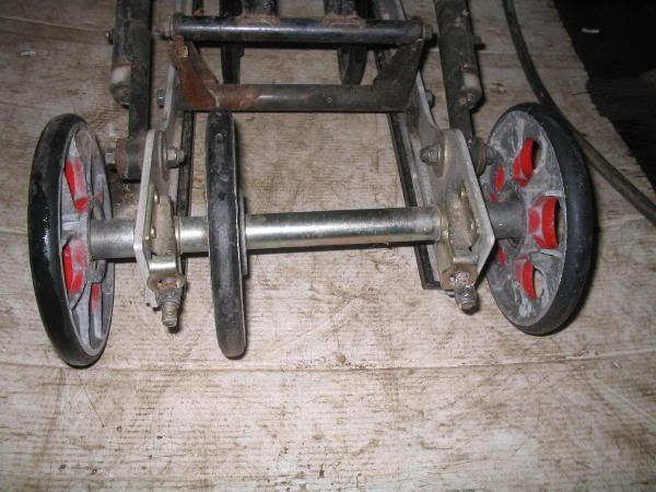

I then turned my attention to the track. It ripped pretty much one whole side off the track. A big strip is still held on by a couple lugs. It damaged the back of the tunnel just a little and removed the snow flap.
I found out why the track failed!
I didn't but a wrench on those adjuster bolts. I cut the track to pull the suspension. Apparently, someone at the service shop forgot to tension the track. It was the right side of the track that failed. That right idler got some pretty severe damage from hitting that bolt.
