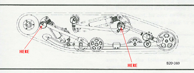

no not the wheels the suspention piviot points,a little tit looking thing
that the grease gun snaps onto,,you have never greased anything???
your grease points will be marked in red it's not the same skid as yours just
a reference pic..
a reference pic..
