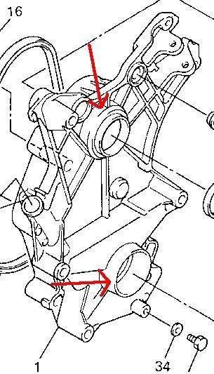

If I read this right, you said to drill a hole into the chaincase, and tap it for a zerk fitting. Whats the benefit of this?

I added grease zerk's to drive bearings at speedo side, bottom and top gear sides so I can at least grease the things. Yeah , yeah there sealed bearings but I removed the seal/wiper from one side and grease it this way. Bearings should last longer than 3-4000 miles. But like all things it needs to be done right. I did it to my SRX600 and just had ran it in the UP this weekend for 600 miles...! more weekend and Ill grease them again. I also switched over to Syn trans fluid on both machines SRX600-SRX700. The 700 gets the upgrade after this season.

The inner bearing by the brake caliper is sealed like this...seal-SEALED BEARING ONLY TOWARD THE CHAINCASE SIDE, It sees no lubrication from the chaincase and is open toward the seal side. I drilled so a hole exits between seal and open side of bearing, now it can be greased. The same applies to the bottom bearing by the gear. Now for the speedo side it has a bearing sealed on both side but I used a pick and removed the seal that is in inboard and tapped the bearing carrier cover and greased.

Exactly...thats why I did the mod. Explains why they only last 3-4000 miles.The bearings are 93306-20592 ((case bottom)) and 93306-20589 ((speedo side)).
BTW this mod is called the "stinger" mod..MY MOD lol.....I will be drilling my spare case but it probably wont happen until it warms up, or the oem bearings fail on the 700 right away.

It sounds like you have a bearing in backwards. I am not saying you are wrong, but I am fairly confident the bearings in the chain case are suppose to be lubricated by the oil. At least most of the chain cases I have seen have been this way...

Nope I have installed them correctly..just the way they came out. I also have the SRX manual on cd and it plainly shows this.

From the pdf
Make sure that the bearing seals face towards the
drive chain as shown.
Straight from the cd...
Seals go towards the gears. Yamaha likes to keep the fine metal filings out of the bearings. At the same time, a small amount of oil will wick past the seal and into the bearing.
I assume you're adding zerks to the general areas shown in the fiche pic? Obviously accounting for ease of access.

Yes..I wish I had ran a line from the bottom fitting to a better place as it is I have to remove the pipes to get to it, but better than changing bearings. Also I wouldnt use a power grease gun, too much grease to fast may blow the seal off the bearing, they are very thin seals they put on the bearings.
