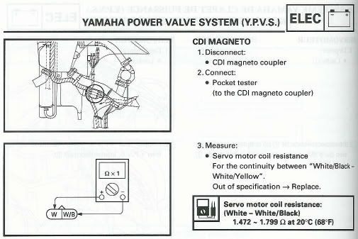

well theres another check we can do,you got a ohm meter to check continuity?
i'll post it up tommarow.
you can do two other things here;
1st test servo motor with 12v's , NOT the idling down engine meathead.
2nd test CDI .
you may have a shot cdi or servo motor,do thos test and post back.
