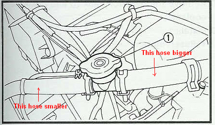

one thing i do notice on model's WO is that the coolant out put flow (thermostat)hose is smaller(1/2 reduced) on the other side of the fill hole(rad cap)VS the front side that clamps onto the thermo housing neck,that there would be a good restriction.
Removing the thermostat does not speed up the coolant flow in any way. The thermostat is only there to help build water temperature quickly. When closed, it is a closed loop that only flows coolant through the motor, to the coolant bottle, and back to the motor. When opened, it allows coolant to flow to the heat exhangers, but also allows coolant to get back to the bottle. The coolant hoses that run from the thermostat to the bottle are smaller so that more of the coolant is forced to travel through the heat exhangers to cool down. However, there is too much coolant travelling through this smaller hose, which results in warm coolant right out of the motor to travel to the bottle, and back to the motor, causing higher water temperatures. You can help to force more coolant through the heat exhangers by installing a plug into that smaller line that goes to the bottle, but that plug must be drilled out to allow some coolant flow. Jabber is right by stating that if you block off the return line (line from the thermostat to the coolant bottle), you will likely cavitate the water pump. The problem with doing this is that is takes quite a bit longer for the coolant to heat up to sufficient operating temperatures since it has to travel through the heat exhangers at all times. You must be more patient in letting the snowmobile warm up, or it will result in cold seizures. I do not run a thermostat in my trail 780, and without it and limiting the coolant flow to the bottle, it runs approx. 20-30 degrees colder at all times.
So, removing the thermostat does not increase temperature whatsoever. Simply removing it and doing nothing additionally will only slow down the temperature buildup, but will not change the overall operationg temperature. Removing the thremostat, and restricting (not blocking) the return line to the bottle will force coolant through the exhangers, and the end result will be a colder running motor.
