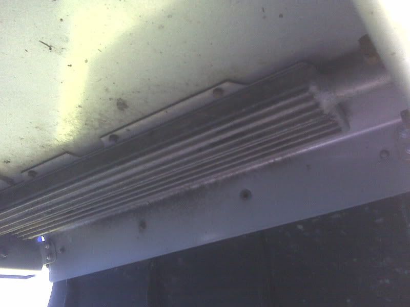

I checked out the rear cooler on my 2002 Mountain Max today and as it looks, the parts and extension are designed to accomidate this cooler, it is much smaller than the rear cooler on the Viper and it also has the 3/4" connections (The Viper coolent system uses 1" hoses
This is the Mountain Max Rear Cooler

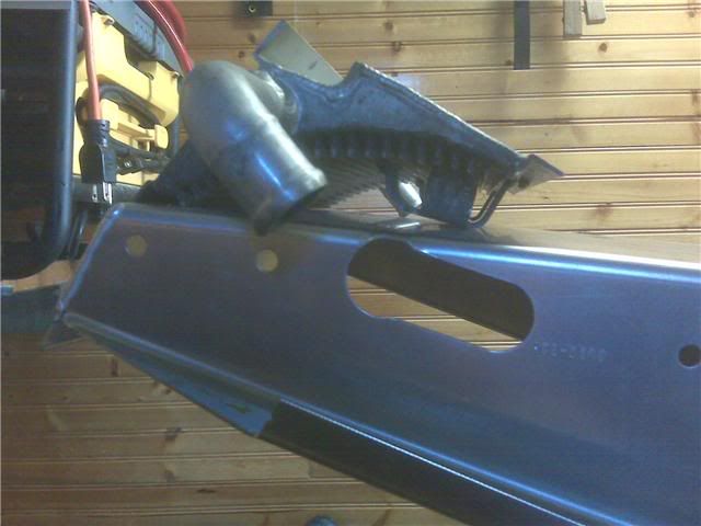

Notice the proposed location for the Viper rear cooler and the location of the holes in the extension

When I put my srx cooler back in my srx I just fired up the cut off wheel and took the back panel off the extension. Opened up the slots for my water bungs and riveted/bolted it in place. The hose covers hid the work I did on the sides and the back doesn't look any different than it ever did. I wanted the bigger rear cooler as I run my sled out west and here at home in MN and with the sometimes marginal trail conditions at home I figured all the cooling I could get the better off I'd be.
I have mounted the little coolers flat in the top of the extension. I seem to remember cutting the bungs off, rotating them slightly, and re-welding. That works well too. This was on a tapered extension that didn't have the lip on the back to mount a cooler vertically too.

When you took the back pannel off did you put it back on? What did you rivet the snow flap to without the pannel in place? I can almost picture what you did because I contemplated doing something like that myself, I just couldn't figure out how it would all work out.
I just left it off and drilled new holes in the bottom lip of the exchanger for the flap.
cacsrx1
I did what Ryan did but I didnt slide the cooler all the way back.
