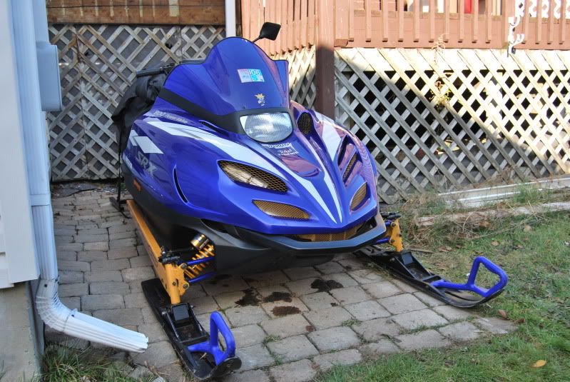

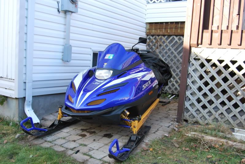

Here's some pic of her after 2 coats of wax
I got her out of the shed last week for the winter and put my bike where she was. I love my SRX.
staggs65
did the older ohlins srx come with those yellow trailing arms? i think that's the first time i've seen that.
No the guy that had it before changed them, I bought the sled last year.
staggs65
i think i'd change em back, just my taste
k k, well I like them, so thats what counts
