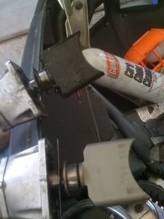

Well even though i was nervous about doing it i dug into my PV's this morning to see what was in store for me. I bought this 03 Viper Mountain from a guy who said he cleaned the PV's at the beginning of every season. Well after pulling them out and looking at them..... I call BULL... that or Yamalube is the worst snowmobile oil in the world as that is what he used for the 7000 miles that is on the sled.
Well here are the pics of before and after so you can see, I soaked them each in a simple green bath for about 30 minutes then used Gumout carb cleaner and a scotchbrite green scrubby. Heading up in the morning looking for snow, we will see how she likes the nice clean PV's

Took about 10 minutes a piece scrubbing the carbon off after soak
another easy way to clean the PV's is to take a small knife and scrape the stuff off...

Thats why one should NEVER take someone's word for it when it comes to PV's. It's soo simple to pull em out and check then clean one should always do it.

He probably did clean them once a year.That's not enough unless you don't ride much.I've had to stop and clean mine half way through a trip.Put on approx. 2,200 miles that week.Most oils used you will have to clean them every 1,000 miles.I usually put too many miles on to be running expensive oil,so I got good at cleaning them.
