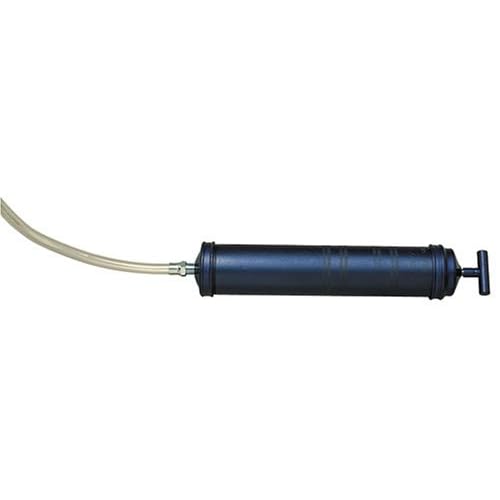

What's the best way to drain oil? Like to get most of it out, just cleaned and adjusted power valves. Thanks for the help!
I use the ole mouth siphon method for oil,gas,,,,,, should use a clear hose
i used my wifes turkey baster, jus dont get caught with your hand in the cookie jar......but my shop is heated and the oil was warm, dont know how how good that would work with cold oil in the tank.
