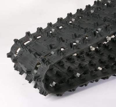

gun lover
I put on Kimpex Shotgun X 1.25 lug .
no Studs
The thing hooks up like you would not believe,on any trail condition.
Im amazingly happy whith this track
gun lover
This is what the lugs look like For the SHOTGUN X
braindead1684
Sick looking track Gun lover,
I but a 1" Predator i believe on mine, works well but i can still spin her (seems better then the over studded track for sure). I went with 1" so i could stud it if i wanted to, however the 1.25 is a GREAT option if you don't want studs more often then not this will give better traction.
If you are on Ice or Hard pack studs will be better, usualy in somewhat loose to powder you will want the deeper lugs studs don't help when they can't grab ice or hardpack.
