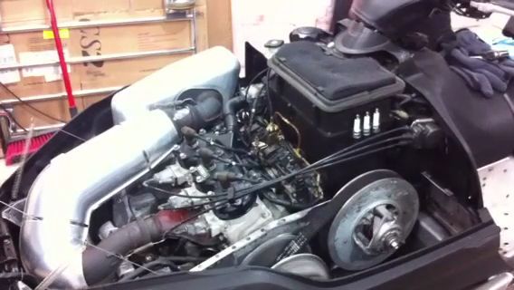

Racing my cousin down the trail and all the sudden I hear a loud rattle and clanking. Lostall power and then the sled died. I have a few vids if how it sounds and really need you guys on this one. And to top it off my Internet is down so im on my phone now. I'll update this post as soon as I can get the vids up. Not a good start to the weekend.
Thinking it's crank bearing. But not sure.

Time to tear it down. Did you look at the plugs yet? Know what cylinder? Make sure you take lots of pics for the guys to help. The more info the better. CCC
Main rod bearing prob the center.. You will need a crankshaft, piston, rings wristpin and bearing. And hopefully NOT a cylinder too. sucks!

Thanks everyone. The primary is frozen and I can't even pull the recoil. If you see in the vid towards the end the primary comes to a complete stop. That was on it's own. No kill switch.

not gonna know until you crack it open to see what went wrong. You can rebuild your motor most likely but again we cant tell till you crack it open. Id say if you only need a crank plust piston and head you should beable to find used for around 600 buck. Just a guess i havnt priced anyting out just a guess. I would see about sending out your crank for rebuild dont get a used crank since the vipers seem to go through cranks more often..

Ouch bud thats to bad!!!! Your going to have to get in the motor for any kind of real help. Might as well tear her down and find out how bad! Take some pics of all of the cylinders pistons and such and post back. We can help find the cause!

I'm thinking about taking the heads off and just looking. I really don't wanna bring it to a dealer

It's a mess. Bringing it in. Guy told me worst case scenario is 2,000-$3,000 for a full rebuild. Oem crank, new seals gaskets bearings , cylinder sleeves, pistons dual ring setup etc etc. Is it even worth it? Considering it will have the same typical crank seal bearing issues as it did before?
