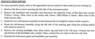

The power valves do work without the white relay. I have the same white and blue relays with matching part numbers in my 96 Kodiak 4x4 so I tried them and got the same results. So I ruled out the relays. (Glad I did not buy them the white one is $50 in Canada) Then I found this; Tech Bulletin S2001-002 is for 2001 SRX700F, 2001SX700F, and MM700F.
Problem is:
1. When headlight switch is in the low position, the engine will start but then quickly shut off. The engine will not stay running unless the haedlight switch is put in the high position when starting.
2. The engine will momentarily drop rpm and somtimes shut off once during the first start up. When restarted, the symptom is gone, and the unit will start and run normally.
Cause:
When the Load Control Relay engages at 700 RPM, it can cause a momentary loss of spark due to low ignition system voltage.
Remedy:
If either sysptom presents itself, replace the headlight relay with the Headlight Relay Kit designed to reduce current draw during start up.
Part #:
90891-50137-00 Headlight Relay Kit - includes sub-harness
Symptom 1 is exactly what it was doing since I bought the sled two years ago.
Symptom 2 is how it is behaving now.
Has any one else tried this fix? How did it work?

That kit does work, I put one on a few years ago and it fixed the problem on my 01 SX-R700. I have another one here now and it does the same thing. I checked and the kit is still available.

I just tried the relay kit in the garage it seems to help but when I switch back and forth from high to low beam the tachometer drops to zero for a moment then comes up again. The engine also drops rpm for a split second. The hand warmers dim the lights when you turn them up and I don't think it did that before. Is that what yours did?edunn69 said:That kit does work, I put one on a few years ago and it fixed the problem on my 01 SX-R700. I have another one here now and it does the same thing. I checked and the kit is still available.
Mine only had the drop of rpm's on start up before installing the kit, its fine after installing. Never noticed any other problems before or after installing the kit.
