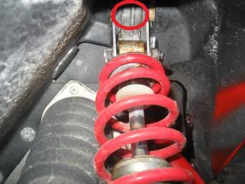

First I have used both tyes on my MM. MM comes with the clevis type shocks. I added the SRX brackets to run a set of shocks off an SRX. When I go to the micro fiche it shows that you are right Staggg that the SRX has a different frame that the SX's,SXR's and the MM's. mes882, can you take a picture of your frame and post it?By the way, I do have set of viper shocks that I tried on my MM for a short while until I bought a set of Ohlins. If your interested, PM me and I'll send you a picture and give you a fair price.
Here are the pics two off them is under the hood where the upper shock bracket mounts and one is of the shock mount on the bracket. I have read about people getting this bushing 8CR-2376B-00-00 which is 19 under skies on an 02 viper

looks like you could run the vipers on those with the bushings, good deal

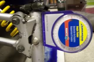

Before you start anything. Use an angle finder/incline meter tool to get the camber of the spindles.
Remove the upper shock mount. I would use new spacers or eyelet mounts for the top of the Viper shock.
Set spring tension to 0 pressure when fully extended. Install the Viper shocks and check the camber/toe again. When I did my 97 sx it all stayed within factory specs.
These are the bushing 8CR-2376B-00-00 you are taking about right. Am I just putting these bushing in the stock upper mount where the shock is mounted now. Or am I taking off the upper mount and putting these bushings in where the upper mount was. Good idea with the angle finder. What is the eyelet mount? where do I get them? A picture of one done would be great if someone has one.
