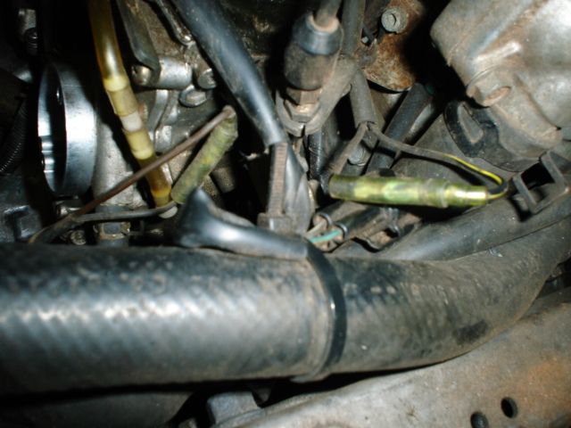

in the manual it says to disconnect 2. ive only found 1 and it was plugged into itself????
Cooper0809
ok, so found the other 1. they were both plugged into eachother and not connected. why would that be? post pics in 5min....

someone already had it bypassed. probably had the cable too tight and didnt know how to fix it.

staggs65 said:someone already had it bypassed. probably had the cable too tight and didnt know how to fix it.
ok, heres a photo anyways. why would they have it by-passed? sorry, cable being tight . didn't read thoroughly.
staggs65
when the tors activates it limits rpms of the engine below clutch engagement. Its a safety feature in case your throttle sticks open. the most common cause of an unwanted tors activation is not having the appropriate freeplay in the throttle cable. next is a dirty or faulty tors switch. a lot of people dont take the time to figure out what it is and bypass it. not really a great idea. it has an important purpose

ok, thanks stags. so how would I go about fixing this? basically just make sure throttle cable has slack?

yes start there and see if you have a tors problem. if you have the tors activating with proper throttle slack then you have either a dirty or bad switch. first try it connected with proper freeplay and go from there.
