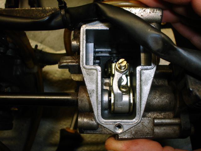

Carb #1 http://i1129.photobucket.com/albums/m504/thiessen1/DSC03766.jpg?t=1356657900

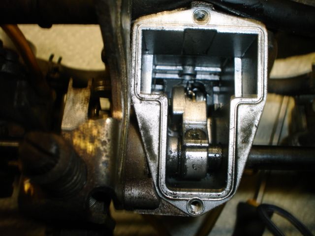

carb #2 http://i1129.photobucket.com/albums/m504/thiessen1/DSC03765.jpg?t=1356657899

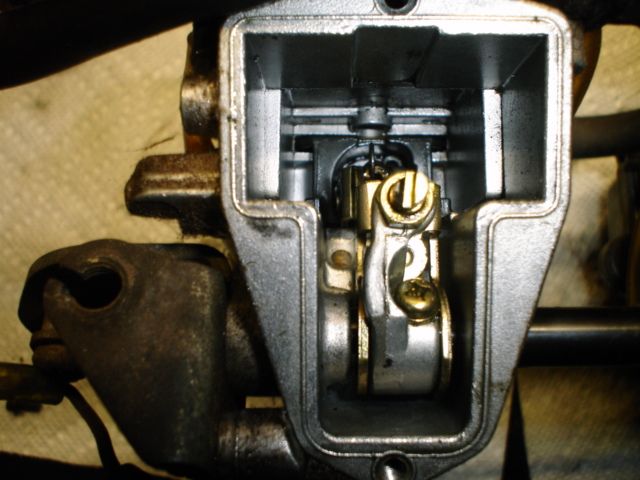

carb #3
http://i1129.photobucket.com/albums/m504/thiessen1/DSC03764.jpg?t=1356657901
is there something missing from the middle carb (#2)?
#1 carb has half the head missing on the screw. can I squirt carb cleaner into the top of them? there pretty dirty looking in there....

middle carb is good. you adjust the other 2 to match that one, that's why there's no adjustment there. carb cleaner wont hurt anything in there

From what I see in your pics yes the half of the one is busted off. Yes you can work the throttle positon and flush the crud out, keep in mind its going into the throat and will then need cleaned out of there.
To answer your other question about the "something missing".Unless I am missing something in the pic what I am seeing is the "slave" carb. The adjusters are for adjusting slide height. The other 2 have to be adjusted to match the slave. Grab a drill index, with the carbs in idle position find a drill bit that will fit snuggley between the slide(part that goes up/down with throttle movement) and the bottom of bore of carb. Check the other 2 adjust as necessary, all should same. Some guys say to check at mid throttle with like a 5/8-3/4in or similar socket, up to you.
