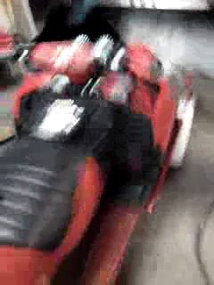

gonna load up a video so you guys can hear.yeah changed plugs, messed with plug caps and connections to coils. How do you bypass at the throttle??
