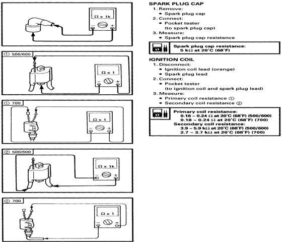

I moved on to testing my coil, although I'm not sure if I'm testing it correctly ? This is what I'm using as a reference :
Keep in mind, the 3rd and 5th illustrations are for the 700.
I pulled my coil off of my sled to test it, I removed the plug caps and when I put the probes from my multi-meter in the leads (20k ohm setting) I get 4.63 ohms which is in spec. When I connect my multi-meter to the orange wire and the mount for the coil on the primary side, I get 0.00 or -0.00 as a reading.
If I change the setting on my multi-meter from 20k ohms to 200 ohms I get a reading of 00.5, my assumption is that my coil is shot ? My sled did start/run, just didn't run very well.

It lists the same specs that I posted above, here's what the manual lists :
If I test the secondary coil (plug leads) I get 4.68 with my meter set at 20k ohms. If I leave my multi-meter on the 20k setting and test the primary coil I get 0.00, if I change it to the 200 setting I get 00.4.
Which setting on my meter am I supposed to use to test the primary ? I'm assuming the 200 ohm setting ?
Either way, my guess is that my coil is shot ?

Looks like the setting should be on 1 Ohm if there is such a thing or the lowest setting on your multimeter.
