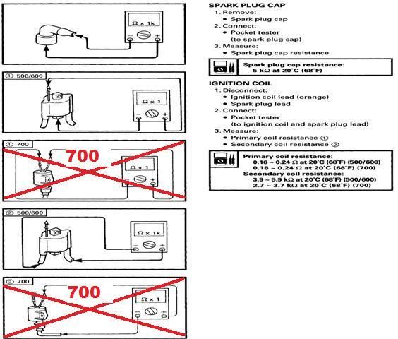

I'm working on to testing my coil, although I'm not sure if I'm testing it correctly ? This is what I'm using as a reference :
I pulled my coil off of my sled to test it, I removed the plug caps and when I put the probes from my multi-meter in the leads - testing secondary coil (20k ohm setting) I get 4.63 ohms which is in spec.
When I connect my multi-meter to the orange wire and the mount for the coil on the opposing side - to test the primary coil, I get 00.5 as a reading. That's with my multi-meter set to 200 ohms. I used my disk grinder to clean up the posts to make sure I'm getting a good connection, they weren't too bad but wanted to make sure it was making good contact.
My assumption is that my coil is shot ? Going by the pic posted above, I think I should be getting 0.16-0.24 at the 200 ohm setting on my meter.My sled did start/run, just didn't run very well.
