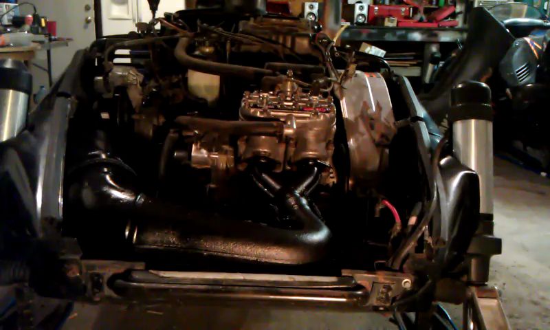

You can see the oil pump right there on the left.....
At least I think that is it,,, is where the cable goes to from the throttle ?
UpstateDoubleD
Yup that's it and boy the oil level didn't seem to go down much..ummmmmUpstateDoubleD said:You can see the oil pump right there on the left.....
I bet I should replace that crusty A.. filter while I'm in there...
