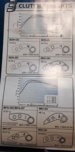

Where do you get one of these charts? That looks like it would be handy to have.I took a picture of my chart. I can take others if needed.
A couple of bucks
It was an extra that my Yamaha dealer had.
There was one on ebay while searching for clutch parts but I stumbled across it by mistake. It was a poster. I didn't look into it though.
