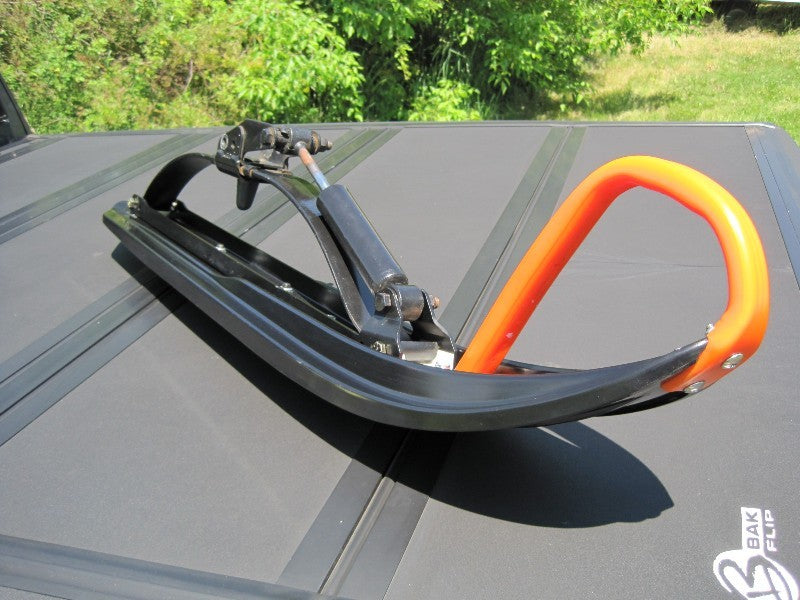

Improvements I know I need are higher engagement and snappier response clutching wise, somehow plastic skis on the leafs, hydro brake setup, newer ripsaw 1.25” SR-V seat… Anyone else with more experience on setup would be super appreciated! Thanks.
