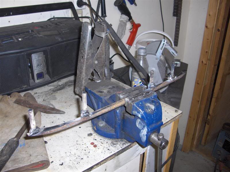

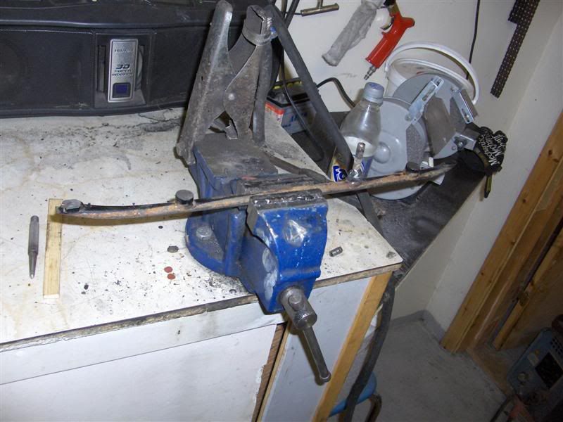

Well I got the sled home and I removed the skis in order to install the new ones.
And, now I know that it`s a 97, or, I guess that the 98 came with plastic skis because I ordered skis for a 98` and the skis I got was made for plastic skis.
However, I figured that with some modifying of the steering irons I could make it fit. (I had to extend the bolts).
First I tried to extend the original bolts by welding a another "bolt" to it (cut from a "gjengestang) and then grind it down so that it was even and then rethread the whole bolt. However, this seemed to be a bad solution because one of the bolts broke off when I put the ski back on the sled. I don`t like to do bad work so I took the steering iron off again and cut of the whole bolt, like this.
I then cut new bolts and welded them onto the steering iron. This became MUCH stronger.
I put the ski back on the sled and finally everything was OK. I`ve never spent 5 hours on changing ONE sled ski, gees hehe!.
Tomorrow I`m going to do the same with the right ski (will take less time when I know exactly how to do it, when it comes to the modifying part) + I`m going to change the exhaust gaskets and clean the carbs.
