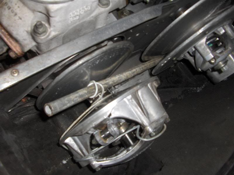

How I locked the primary. How does the pro`s do it?. I used a steel wire and an iron tube... works great.
The bolt loosened pretty easy. I installed the puller started to tighten it. I put MUCH force on it, nothing happened. Then I tried heating it with a propane heater, but nothing happened. (the propan heater did the job when I removed the primary on that XT).

Today I spent about 4 hours to get the primary off.
First I cut off the thin part from the puller and replaced it with a screw, welded it onto the puller.
When tigtening puller it got bent, just like the stock puller.
I went back to my workshop and cut the screw off, then I found a 10mm steel "bore" ? (what`s it called in english) that I cut down to the right length and welded onto the puller.
Went back to the sled and made another attempt. Still the same. The "bore" got bent.
My dad was surprised by the difficult "level" of this operation but he came up with a good idea that solved the problem.
I had an old primary bolt lying around. We cut it down do a suitable length. I then used the angle grinder so cut a "trace" in the end of the screw so that I could use a flat screw driver on it. (on the end that not is threaded).
I then pushed a copper tube over the bolt to stop it from getting bent when torqued inside the puller. I then cut the head of an old puller and grinded it down so that it fit inside the tube that was on the screw, this would make the "connection" better, better "steering".
I then put the screw inside the primary and screwed it in till it stopped.
Then I put the "puller" inside the primary and startet putting torque on it.
When the puller hit the screw there was a much more "contant" stop.
We heated the inside of the primary a little and then I started torquing the puller like no one has ever seen before, I`m sure.
Suddenly it popped off !!. Gees we were so glad... you should only know.
