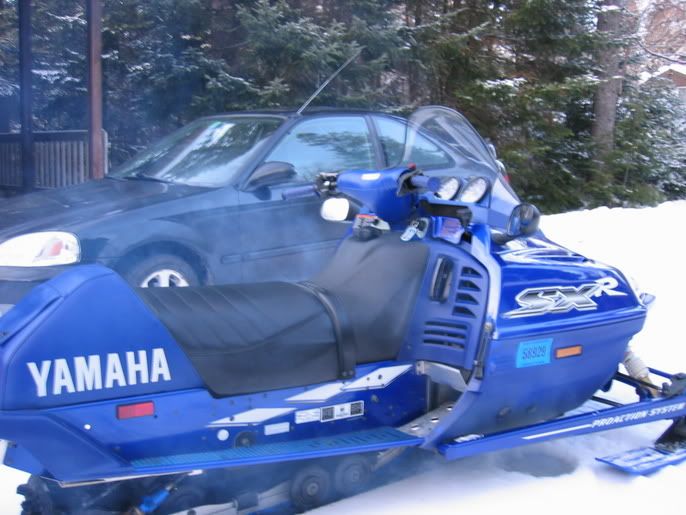

the viper is an update on the sxr. it is a long travel trail sled. it also has the powervalves like the srx, so the low end grunt is a lot better than the sxr. otherwise, it is a cool looking sxr. here is mine, with a low windshield and yamaha skis on it.
you can see it also has a better gauge package than the sxr. but that is no dig on the sxr, it is also a very nice sled!
Wow awesome looking sleds.
