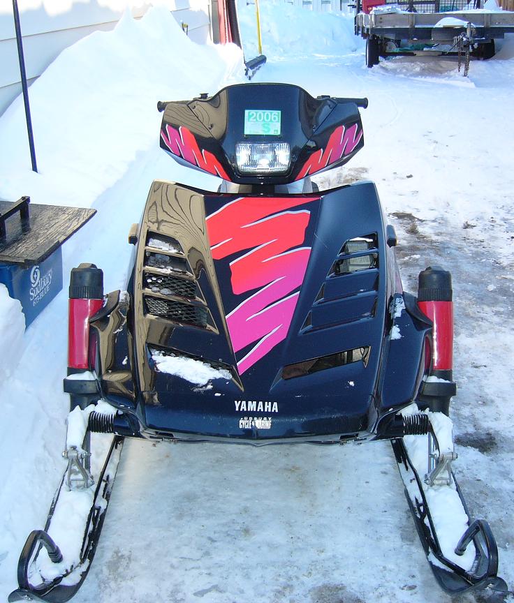

Can anyone fill me in on the differences between the 93 Exciter II SX and the standard Exciter II ?
I heard they had adjustable struts but don't know what else.

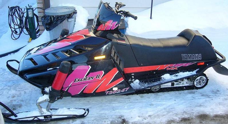

Cool Vid of my SX :
http://www.domesticcrew.com/marvin/Sled/Mars_drop.mov
Not sure why but my sled has NO beans, never did. It barely does 85 MPH. I tried to figure it out, but never could.

Do you have any more pictures of that beauty ?
I really want to know some more facts about it and see some more pics of it !!
