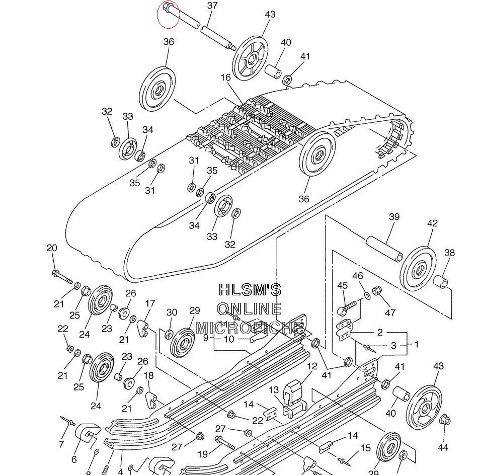

I made my own two wheel rear end kit on my exciter for a whoping $8.97. Pictured in this picture.
Anyway, I can do a writeup pretty easily for anyone there is any interest.

Well, it's actually closer to $10
The origional axle has a nut threaded on to one end and a bolt threaded into the other end and goes the full distance for two outside wheels and one inside wheel. The wheels slide over this axle and are spaced to the correct positions by a collars that slide over the axle.
At the hardware store I bought a 7/16 grade eight bolt and washer for ~1.50 and a drill and tap combo for ~7.50.
I cut the bolt end (not the nut end) off the axle at the correct length and drilled and tapped a new hole for the new bolt. Threaded that in with the washer, then added one of the larger washers that was previously on the axle.
That was all that had to be done to the axle, next I had to cut the collar down. Between the rails is a long collar and a short one to locate the wheel in the right position (I don't know why Yamaha chose to use one wheel in the rear on just one side). Anyway, I cut a section off the long collar equal to the length of the short one and then cut the long one down the rest of the way to correctly locate the second wheel inside the rails.
Then just bolt it all together.
I guess I'll do a full writeup just for the heck of it. I can get the measurements up here soon.

Wierd, you're saying the bolt on yours (circled) is not actually a bolt, but it's a hole with another bolt going into it?

actually marsman there is a rollpin through that bolt to hold it in there. i have broken a couple and just tapped out the hole bigger and used loctite with a coarse thread bolt to put it back together.

Exactly. The shaft is just aluminum with a bolt taped into the one end of it. All I did was shorten it and do the same thing.
