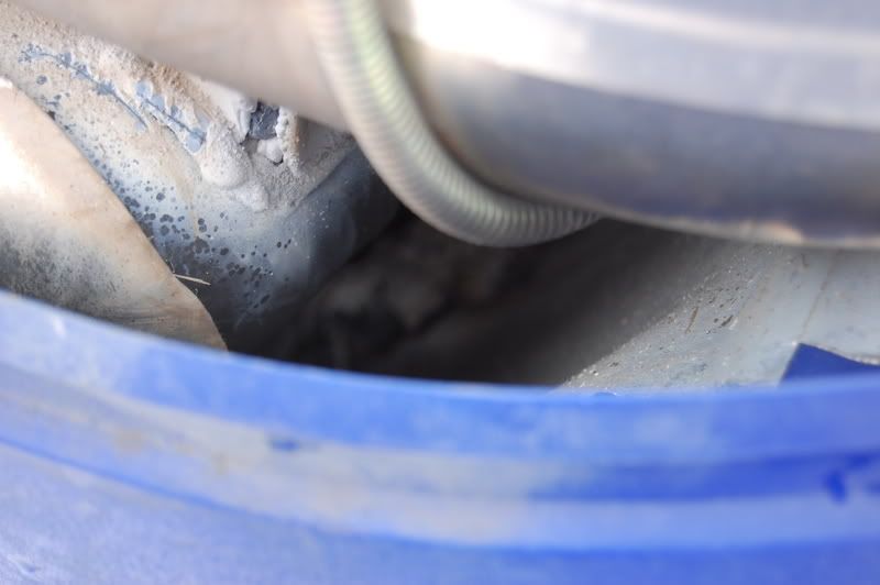

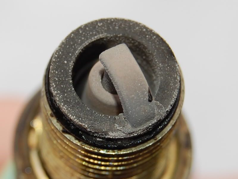

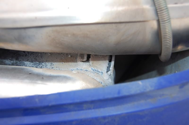

Rode all weekend and it was fine. Then rode for about 45 minutes this morning when I found a real nice alfalfa field. Did about 6 runs between 1/2 to full throttle. The runs was about 1/2 mile long. The snow was about 12" deep too so there was lots for cooling. I could feel my right foot getting very hot and could start to smell soemthing, not sure what though. i rode it home about a mile and took these photos of the top of the muffler, under the pipes. There was also a pile of the same stuff in the belly pan under the muffler. What the heck is it? I don't think it was blowing up, here is a photo of the plugs too. I was using premium fuel too. Thanks for the assistance.

strange stuff.Something was cooking.Exhaust vent was plugging up and the heat stayed inside can more.Anymore of that and you would of been on fire,and not just your foot.Better check your pistons to.Maybe you were melting the coatimg on your pistons,plugs don't look to good color wise.Stuff oozed thru the exhaust,baked on to the can.Now your pistons are in your exhaust can...lol
did you have any discolor at the head pipes?i had this happen on a old phazer.it turnrd out over the summer mice made a nest in the muffler.appearantly it was way in there because it worked ok for about a month,then all clogged up at the outlet.
Exact thing happened to me last year. I was running 3-4 miles across the lake 3/4 throttle and all of a sudden it felt like i fouled a plug so i pulled off the lake. Took my helmet of and right away i could smell something burning, I poped the hood and sure enough she was on fire! I was running in about 20-25 inches of powder, and like blue said, the exhaust outlet must have meen plugged and held the heat in the pipes, The fire took out the belly pan, all three pipes, wiring harness, recoil, collant hoses, and all the foam under the hood, all in all it was an expensive lesson learned.
your playing with fire boys.Plug up them outlets in the summer.Mice will find the most tiny opening for making their next.Use moth balls everywhere and poison pellets to get rid of them.I know one year thet started to munch on my SXR air fliter and ate the fine mesh on the sleds cover that goes over the windshield.Damn critters...hate them and have a lot out here in the country.
that'll teach ya for going into man Alfalfa field.Done that and the alfalfa really traps the snow so you have to pin it.But the SRX is not a deep snow sled and you are working it good.Even with my SXR600 with 1 1/4 track,I have it pinned and was starting to rachet I found out.Had to tighten up track.Imagine the heat you are creating in the clutches to running it full bore in the powder.SRX is not set up for this,but it is your sled.....lol Lucky you didn't blow up the motor,but you better check it out now.

I don't know what the white specks are, I didn't see them when I looked at the plugs, only after the photo was taken.

First thing you need to do is remove your pipes and see whats happening. My thoughts are mouse nest but you wont know untill you take them off and shake them get a small flashlight too. Id also take you header pipes off and look at the pistons plus while your in there clean and adjust your power valves.

I did the exact same thing. There is a rubber bumper under there and it caught fire just like mine and it helped the cover melt right above it.
those plugs do not look good at all, i'd definately be doing a comp. test on all 3 and comparing, those white specks look like aluminum i.e. parts of your piston. could have had something in the carb and she leaned out on ya....

Take the silencer off and start the sled and make sure exhaust pressure is basically even out of all three pipes.
Then inspect the silencer for any rattles and rodents. R&R
I hope not! Funny thing is I couldn't see them when looking at them, it was as if the flash of the camera brought them out. Either way I'll be doing a compression test.
