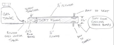

Hey guys here's some eye candy. Sorry I didn't take any pics while I was making it. I didn't know if was going to work out. Its just plywood, foam and black seat material from an old seat. It measures 2.5 inch in the front and 3.5 in the rear. It actually makes my seat ride on top the tank if you choose to mount it where I did. I'm glad I did. It did looked weird with the gap between the seat and the tank so I bought a little storage/map pouch, slapped it on, and it looks great! Most comfortable riding position I have ever had.

did u just mount the seat on top of the spacer? how does all that mount up? I am interested in putting a riser on but I dont understand how you mount it? Is that 2 inches the full length of the seat or just the back?

This is how I did mine but I am not an expert and you could make this a hundred different ways and it will still make your Viper ride better than stock. I screwed the 2x3 at the front and left the back only held together by the seat vinyl so it would give the seat more cushion. You will have to figure out a way to keep the bolts from spinning inside the seat. I welded washers on the bolts and screwed them to the plywood.
I hear you stevie... I recently made a seat riser for my viper and it's like a new sled. I currently have a 2" handlebar riser, but plan to switch it out with a 3.5" Rox pivot riser. Mine is approx 2" in the front and 3.25" in the rear. I added a steel strap in the front so that the seat would install like it's designed to. A few others on here gave me the idea of making the steel strap and bolt it directly to the two bolts holding the tank.
Here are a few pics. In short, I made mine with pink board, peg board, wrapped the edging with thin armaflex tape, waterproofed it with 4mil plastic and then finished it with black vinyl. I orig had planned on using just pink board to keep the weight down, but i couldn't come up with a good way to protect it without adding a solid material.
