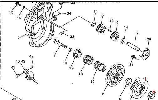

When the chain case cover was bolted down all the way, It was actually pressing up agains end flange on the big gear (outer). SO Im in need of like 3/16 of an inch.
I have an exploded view of the chaincase assembly, and it seems like I installed everything proplery.....the reverse functions perfect when I let off the bolts a bit (still slight drag) when cover is right off, freee wheels with no drag at all.
So, the chaincase and guts are from a 97 sx700. Was hoping someone could help out with perhaps a better exploded assembly view or offer advice about how to assemble the gearset and extras.
I literally had to pry the cover iff before it would spew any oil, so Im wondering if theres a way to build up the gasket, else tighten the bolts less? if I have it assembled properly?
I just double checked, and its assembled exactly how its supposed to be. The collars are in the right spots and oriented the right way and I tightened the bolt pretty darn tight....
I wonder how loose I can get away with, on the chaincase cover. Maybe I tightened it way too much?
OK, I think I may have figured it out, but need some help ASAP.
I may have re-used a spacer from my original srx parts, that I had between 1 and 2 on the diagram. I just need to know if:
A - does #2's small flange go right up against bearing housing?
B - does the end of #17 press up against the back of #2?
ok ..number 17 is rubbing the case cover you said ? number 19 would rub before 17 ....sounds like you have got the wrong spacer between a gear ....wasnt you missing a spacer or washer when you bought the kit ? i have my setup laying on that work bench rite now ....did you remove the orgional spacer were number 7 ? got to be something simple we are over looking ...my kit come from the same sled and worked great ....but i remember having a problem like you also but been a few months since i assembled ...i will be in the shop workin sunday night and monday and ill have to see .....hey you still have the pics i sent you ? can you forward them back to me so i can send them to another guy who wants to do the same ....keep me posted chilli and ill assemble my kit and video it and try to post so you can compare your to mine ...
no its #19 that is rubbing on the chaincase cover. The spacer sems like it is from my original stuff.
Where I drew #2, the small side of that is right up against the bearing. then I had the spacer in between that and 17, but I dont see anything like that on there, and that spacer is the exact amount I need to not rub.
Seeing how this spacer is not on the exploded view, and I am rubbing by exactly that much, it seems like it has to be that.

just a thought but did you get number 9 all the way tight ? i want to say that no spacer goes between bottom gear number 2 ...or is just a flat washer with no shoulder ..but i would have to goto shop and see what i have in my pile .....sounds like you are very close but missing something simple ....i will assemble mine and measure thickness for you so we can figure out what your problem is but i am thinking it is the spacer ..hope you figure it out and get to riding but ill contact you when i do mine again
ok i just went to shop and got my setup and i do have what you labled as number 2 .....i stacked number 1,2,6,8,17 and 19 ..and took a picture and measured it so you can make sure the thickness is rite here is a picture for you .....1/16 inch over 3 1/4 ...

OK glad to hear you DO have #2, and glad also that you dont have that spacer I speak of
Yeah, 9 was very tight when I checked it.
Its the spacer, it has to be
Ill measure mine as well when I go out there later, but I am very confident that is the issue. The chain did nook a little bit twisted too before. I thought it was just me "looking" for problems, but I bet it'll sit more true on the gear now too
