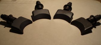

:rofl::rofl:Been there,done that.Got 2 sets of PV's,so I just swap them when needed and clean when I have time,not clean on the spot in order to get things back in the same day.Also have all my clutches rebuilt with a spare Primary just in case or for a different setup on the go without down time.It is all about down time.I eliminate that with extra parts that I stock.

Well the 3 PV's from left to right I picked up from harness racer.They where mega dirty when I got them.I complained to him and he said if he had to clean them it would cost me more.So I vleaned them myself and it took a while.The fourth one in the pic is one of my other extra ones.I have 3 in the sled now and one in the cupboard which has pulled thru and I still am going to repair it.
After I finished cleaning the valves I gave them a coating of Graphite Lube.It forms a dry lubricant that does not collect dirt or grime.Should be easier to clean valves later to.
