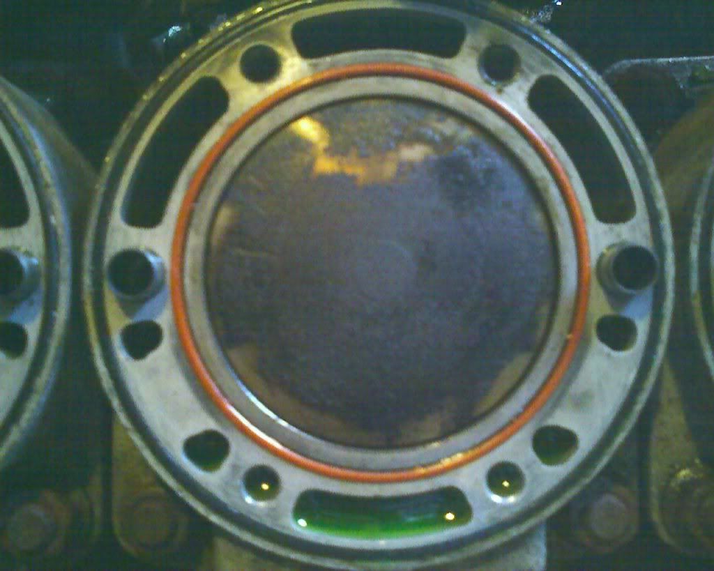

So???
I think it looks to be really close to dead on, if not dead on?
mopar1rules
it won't let me see any pics. can you just post them here?
PTO:
Center:
MAG:
Center:
MAG:

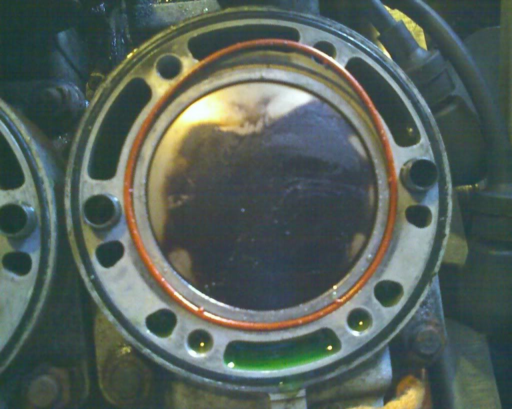

Center looks a little rich?
1st one is rich
2nd one is good(close enuff)
3rd one is the richest one.
So B/c it's getting too much fuel it's washing the piston top clean where the ports are?
A pencil eraser size clear spot at the transfers is perfect jetting.
Ok that's great. Thanks a lot man! You really are a wealth of knowledge!

that is correct.98700 said:So B/c it's getting too much fuel it's washing the piston top clean where the ports are?
daman said:that is correct.
Thank you also, I have 155 mains in there now. I'll see what I got for jets, But I think it might be ok. As I rode in cool weather, not the COLD weather I ride in Usually.
check your jetting(wash)in the temps you usally ride in,do a full throttle98700 said:Thank you also, I have 155 mains in there now. I'll see what I got for jets, But I think it might be ok. As I rode in cool weather, not the COLD weather I ride in Usually.
pull for about 100 or so feet then hit the kill switch pull plugs,then do the
same for each circut,low,Mid range...

100 feet of wot won't tell you squat. you need to run it wot for 6-9 sec, which would be 600-1000 feet. you could back down on your main jets 1 size and still be ok. your wash is rich.
I said a 100 OR so.....that's all i ever do and it works out just fine, thats all ya needmopar1rules said:100 feet of wot won't tell you squat. you need to run it wot for 6-9 sec, which would be 600-1000 feet. you could back down on your main jets 1 size and still be ok. your wash is rich.
if your lean to start you could smoke her if ya do a long pull,,,,ya start off small at least i do...
mopar1rules
100 feet would be covered in like 2-3 sec from a dead stop. what ever circuit you are testing, be it the pilot, needle, or mains, you are not at that particular throttle position long enough, to get an accurate plug/wash reading. you say if you are too lean, that you could smoke it, in a distance over 100feet? that's why you always start like 2 sizes fatter than needed, so while testing, you see how rich you are, and you back down from there. always better/safer to start rich. you also said that you use 100 feet of wot for your testing? what are you testing? you say you are a stock guy, so what would you be performing jetting tests for?
