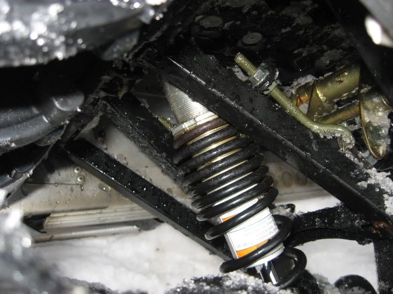

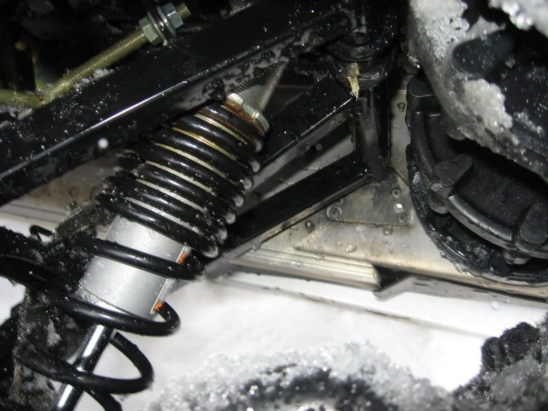

I've got an 03 Viper and I have never been able to make it lift the skis. Tried everything including the transfer rods, but have given up.
Went from this:
to this:
It made no difference.
Not necessarily. Most drag racers I know adjust them so it will pull the skis off the line because it is less resistance. Check out Mrviper700's avatar.
And all mountain riders I know loosen them so that it will pack the skis in the powder, same reason, less drag/resistance. There is a fine line to adjust for, want the skis to lift to remove the resistance they create, but don't want to lift so much that you lose some of the front of the track off the snow and thus lose some of the traction you could be getting.
As far as trail riding goes though, most want them pretty tight so they can get back on the gas halfway through a corner and not have the skis come up and they end up going in a straight line. Its all in what type of riding a person likes to do.
