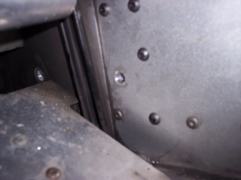

well, yesterday i installed my IQ suspension in my SRX, the install went suprisingly smooth and everything fit great. i didnt take as many pics as i wanted to,, i didnt get a measurment or pics of the before height but here are the pics i did get. my only issue is the scissor arm stop blocks. without wieght on the sled it sits against the forward block, but when i sit on it, it compresses and sits against the back block. should it rest againt the back stop block with just my weight on the sled? youll see what i mean in the pics.

for spacers i made 4"x5"x1/2" plates for the fornt and fastened them to the tunnel with 1/4-20 button heads. for the back holes i used large washers to take up the space between the tunnel and the skid. the IQ skid is 1" narrower than the no-action.
just set in there to check alignment and fit
and here it is all tightened up and sitting on the ground
now this is what i was refering to earlier about the scissor arm stop blocks: sitting on ground, no weight on sled
now with my weight on sled
is this how its supposed to be? seems to me this is similar to the transfer rods on the no-action. should this be 50/50 like the no-action or am i all wrong about this? if this is sitting wrong how can i fix it? there are only 2 different places that i found (besides the stop blocks) that i could possibly adjust it (pictured below)
im wondering how it can transfer any weight at all with is resting on the stops. any input?
