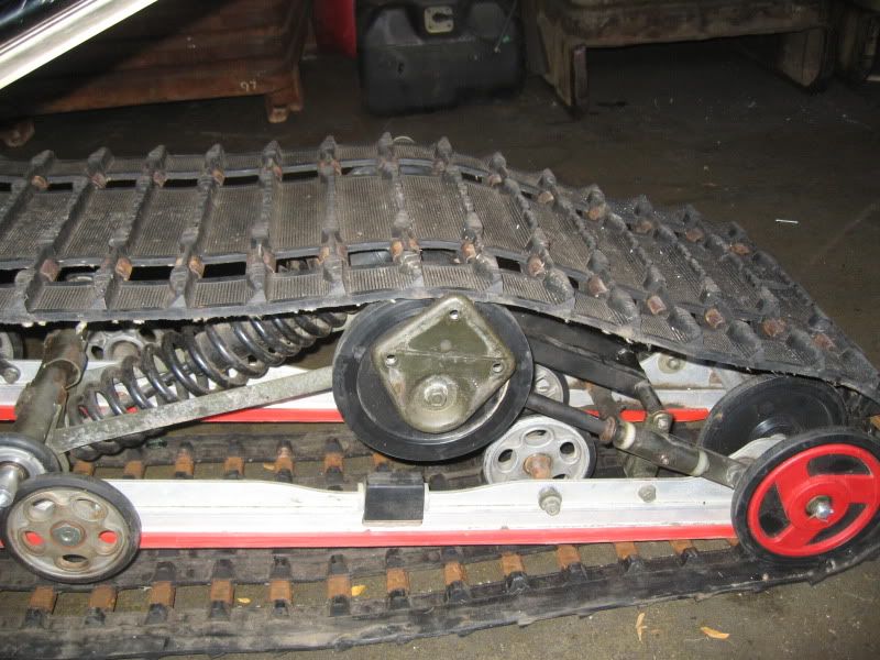

excellent , thanks a ton..... one more question for you , what do i do if my rear mount looks like this.
would i just measure to this point :REAR 15 5/8 from Center C to C. 4 3/8 down from top of tunnel. and center the shaft at that point and drill for the bracket ?
Same bracket I have, the dimension I wrote where for the center hole on that bracket.......Good Luck

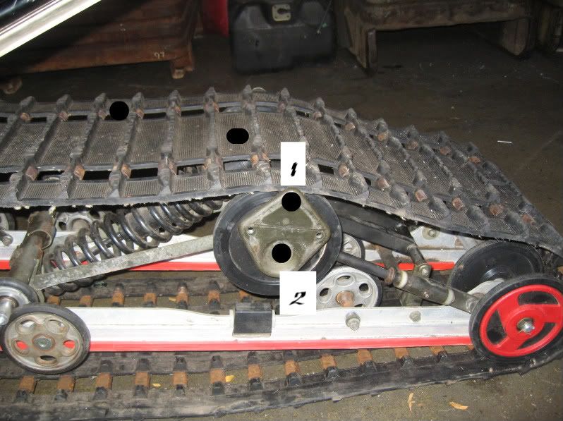

hey nick , thanks for the help and quick replys. just double checkin so i can get this right on my first try. i assume the hole being refered to as the middle hole on the bracket is in fact the one i labled "1" ?
excellent, thanks nick. and i was worried id have to do it by trial and error , i knew id find the answers here.
